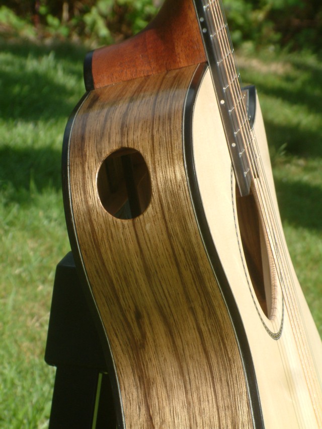

Sam Price has already posted some pictures of this guitar on the Cheltenham Guitar Show thread, but I thought I'd give it it's own thread in honour of Zootman Bob C's wonderful Black Limba. I built this very quickly - starting in the second week of August with a view to having it for sale at Cheltenham but Suzy fell so in love with it that I couldn't sell it and now have it as a demonstration guitar (cared for by a certain person ). Also it's not in line with what I do - I like to make comissions for people that are bespoke instruments rather than making and then trying to sell.

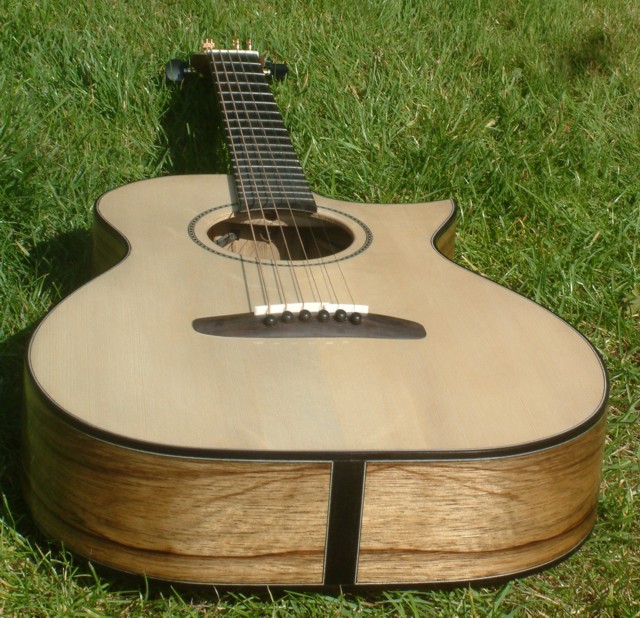

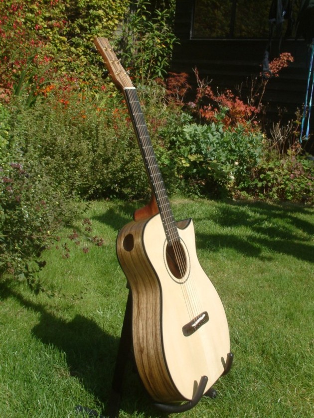

The fit and finish leave a little to be desired as it had to be made in a hurry - mainly the mitres around the cutaway area - but soundwise I am delighted. It very quickly became a Florentine cutaway model when I had a slight mishap bending the first side . Ok some details:

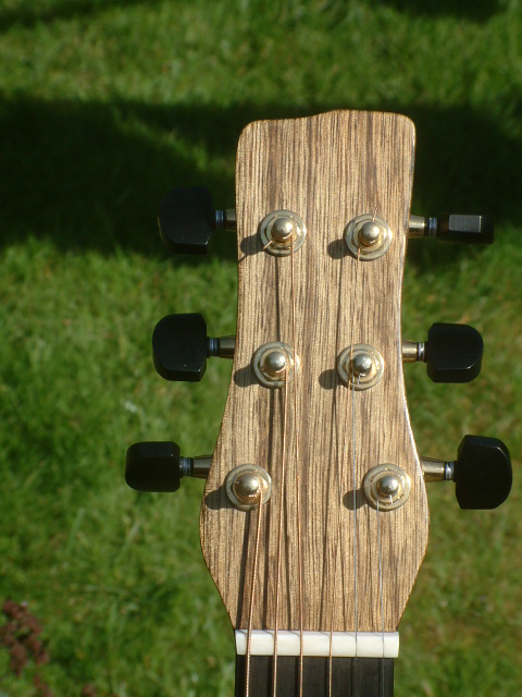

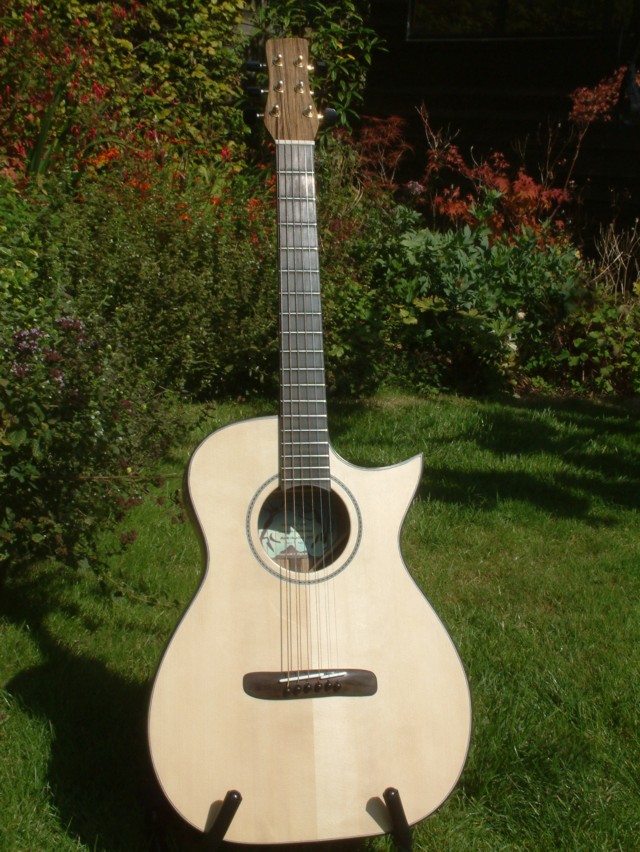

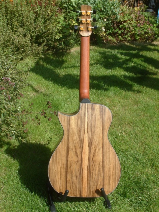

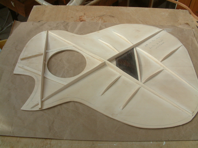

It is based around my Samhain Grand Concert model but I wanted to try what is (for me) a shorter scale length of 630mm (24.8") and I decided to make it a 13 fret body join as that seemed to fit. The top is Euro spruce with Black Limba b/s and mahogany neck. Binding is ebony with bwb side and top/back purfling, fingerboard and tail wedge are ebony, bridge is Old Rio Rosewood with ebony pins, and the headstock front and back veneers are Black Limba. Tuners are Gotoh with ebony buttons. The back is my X brace/ladder hybrid and the top is my usual bracing pattern but is the lightest bracing I have gone with so far. It has the cf flying buttress braces and free floating neck. Finish is two coats of pre-catalysed lacquer (over Z-Poxy on the b/s) and Tru-oil over Z-Poxy on the neck:

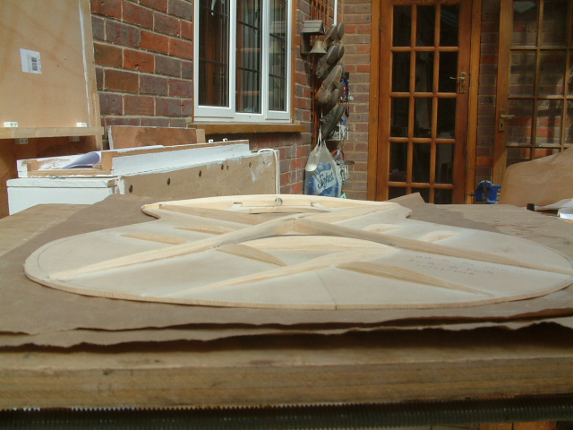

And here's a couple of pictures of the top bracing:
This is the first time I've bought wood from Bob and it's an absolute pleasure dealing with him. The Black Limba is fabulous to work with and takes a finish really well. It has the feel of Mahogany and Walnut and soundwise I think is in that sort of territory - early days for me to tell yet. It has a nice balance with a lovely bass and nice complex trebles high up the neck. It looks fabulous and was attracting a lot of attention at Cheltenham. The neck colour is currently too red and I think I will need to strip it back and work out how to darken it to a more deep brown - any suggestions?

Lovely sound Dave, I see you've put in the brace behind the bridge patch, I use that on all of my guitars and like the way it seems to add a bit of punch. You know I like all of your guitars, so I'll just say that this one doesn't dissapoint.

First, the sound hole looks oversize?? This may be an optical illusion, but it seems large for the guitar. Is it larger than 4"?
Also, on the 5th picture (looking inside at the neck block) I notice some extra hardware in there (black objects on either side of the neck block). What is it?

I've always used that behind the bridge brace as that's what was on the Dermot McIlroy guitar I had that was the first inspiration (plus Stefan Sobell's) for my instruments. I think that Black Limba and Lutz would be a fabulous combination. I'm still trying to decide what "flavours" it is adding as each guitar you make takes your building subtly forward with other changes. On BoB C's website there is a Renato Bellucci custom classical guitar using Black Limba based on the 1968 Fleta mode and incorporating designs from the 1943 Hauser to improve the sustain of the guitar. Bob comments: "Based on my discussions with Renato, the guitar has incredible sustain in the trebles, and the basses are full and rounded." This is what I am hearing on mine currently. I'm hearing a little bit more fundemental balance in the guitars voice as well. My current "feel" for Black Limba is mahoganyesque with some Walnut flavours It works like a dream and is visually stunning.

Yes - the soundhole is 106mm diameter (4.17"). It is part of my overall design though and goes with the big top arch, narrow X brace angle and forward shifted poition of the soundhole. The larger soundhole helps volume and projection on my guitars.
The "black objects" are the carbon-fibre flying buttress braces that let me do a free floating neck/fretboard and concentrate on bracing all of the top for sound. I learned these techniques from the building of Mike Doolin, Rick Turner and Howard Klepper. I just smile quietly to myself now when I read statements to the effect that the guitar's upper bout is tonally dead You can find out more abot the cf braces here on my website and also look at the guitar-cittern and harp-guitar build photo documentaries there.
